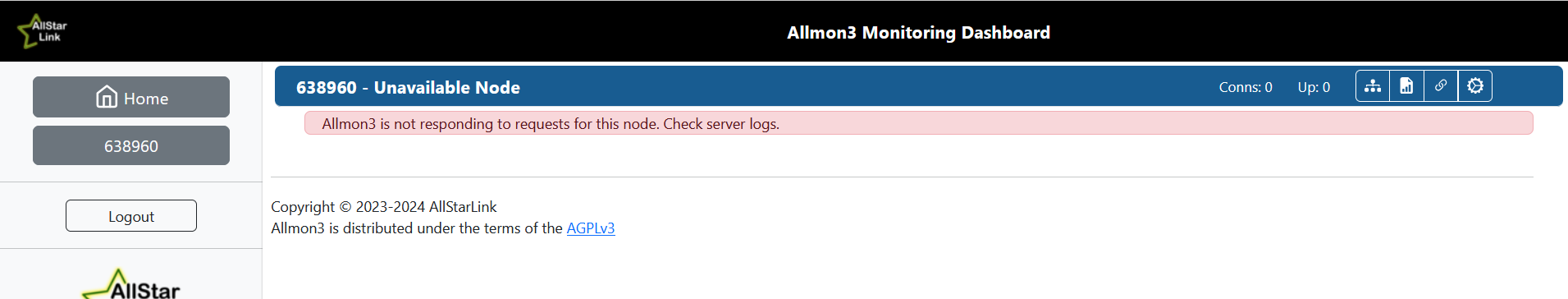

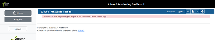

I tried three different password username (from my node etc) and nothing. The error i get from journalctl is
gen 28 07:38:41 voip allmon3[576]: ERROR: (asl_allmon.allmon3_ws_status) No connection for 127.0.0.1:5038 on 16700 due to unreachable AMI - waiting 15 seconds
gen 28 07:38:57 voip allmon3[576]: ERROR: (asl_allmon.ami_conn) Logon failure msg=(Response: Error Message: Authentication failed )
moreover, i have the same password in allmon3.ini and manager.conf.
allmon.ini
[638960]
host=127.0.0.1
user=admin
pass=1545
; Asterisk Call Management support
; By default asterisk will listen on localhost only.
[general]
enabled = yes
port = 5038
bindaddr = 127.0.0.1 ; Comment when not localhost access
[admin]
secret = 1545
read = all,system,call,log,verbose,command,agent,user,config
write = all,system,call,log,verbose,command,agent,user,config
;deny = 0.0.0.0/0.0.0.0 ; Uncomment when not localhost
;permit=1.2.3.4/255.255.255.255 ; Uncomment when not localhost
It WORKS!!!
I changed again all password and now it seems to work.
