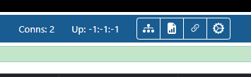

Allmon3 Dashboard Showing -1: -1 :-1 Up time
Anyone knows why this is happening?
Allmon3 Dashboard Showing -1: -1: -1 Up time
I have 2 hub nodes. I already configured successfully my main node to monitor the other node on the same dashboard and the uptime is also being displayed. The nodes configured on this main hub node is not displaying the up time.

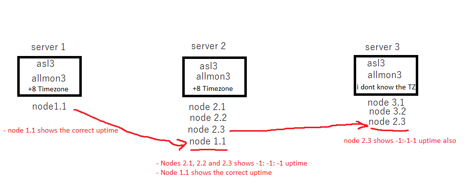

Here is how the nodes being setuped.
Nodes 1.1 and 2.3 are being monitored remotely by different allmon3 dashboards.
