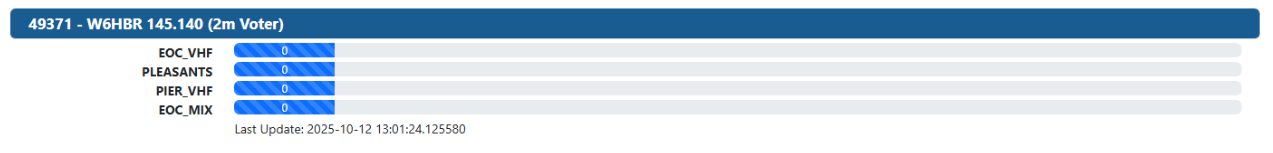

voter.html is modified to only show the actual voter data like the image below. (unused code in voter.html is simply commented out as to allow easier code comparison when new versions are released).

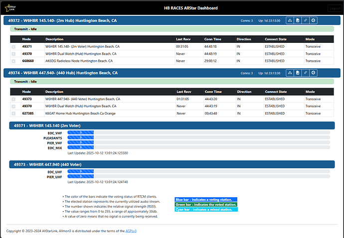

index.html is then modified to have voter.html inserted via two iframes at the bottom - one for each of my voting nodes. Below the iframes the voting legend info is also inserted in the index.html file.
Additional changes include hiding the sidebar with a css block in custom.css

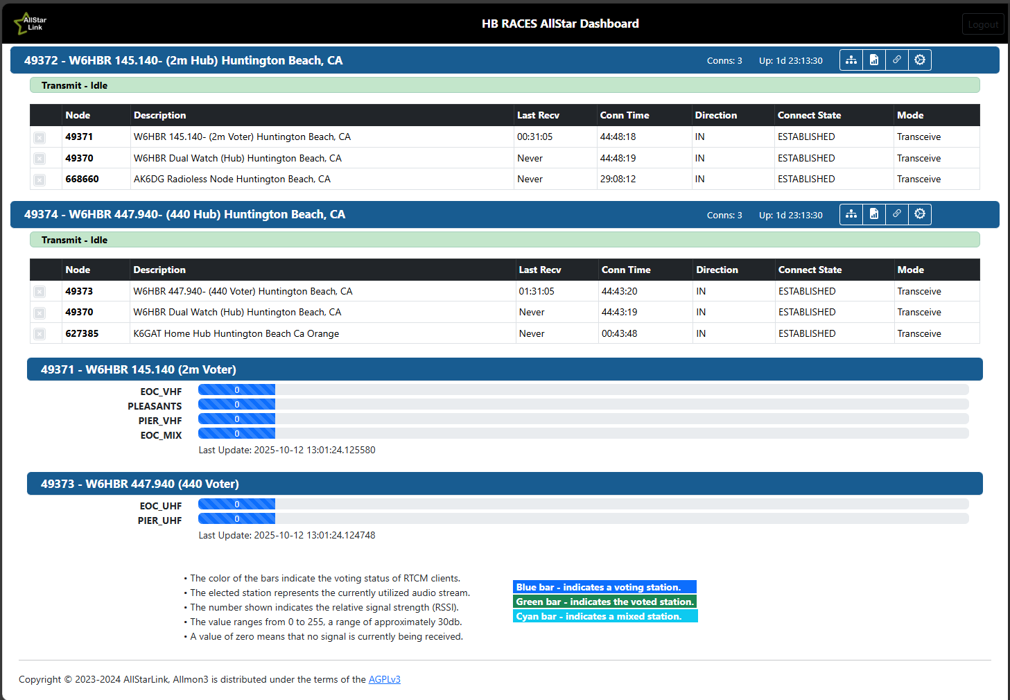

I think the best (and easiest) option is to just combine index.html and voter.html:
This would still be fully user controllable and would work for all use cases.
This is what I was thinking of...
Which, if the above suggestion (combine index.html and voter.html) were implemented, then links to voter.html would not be needed at all.
