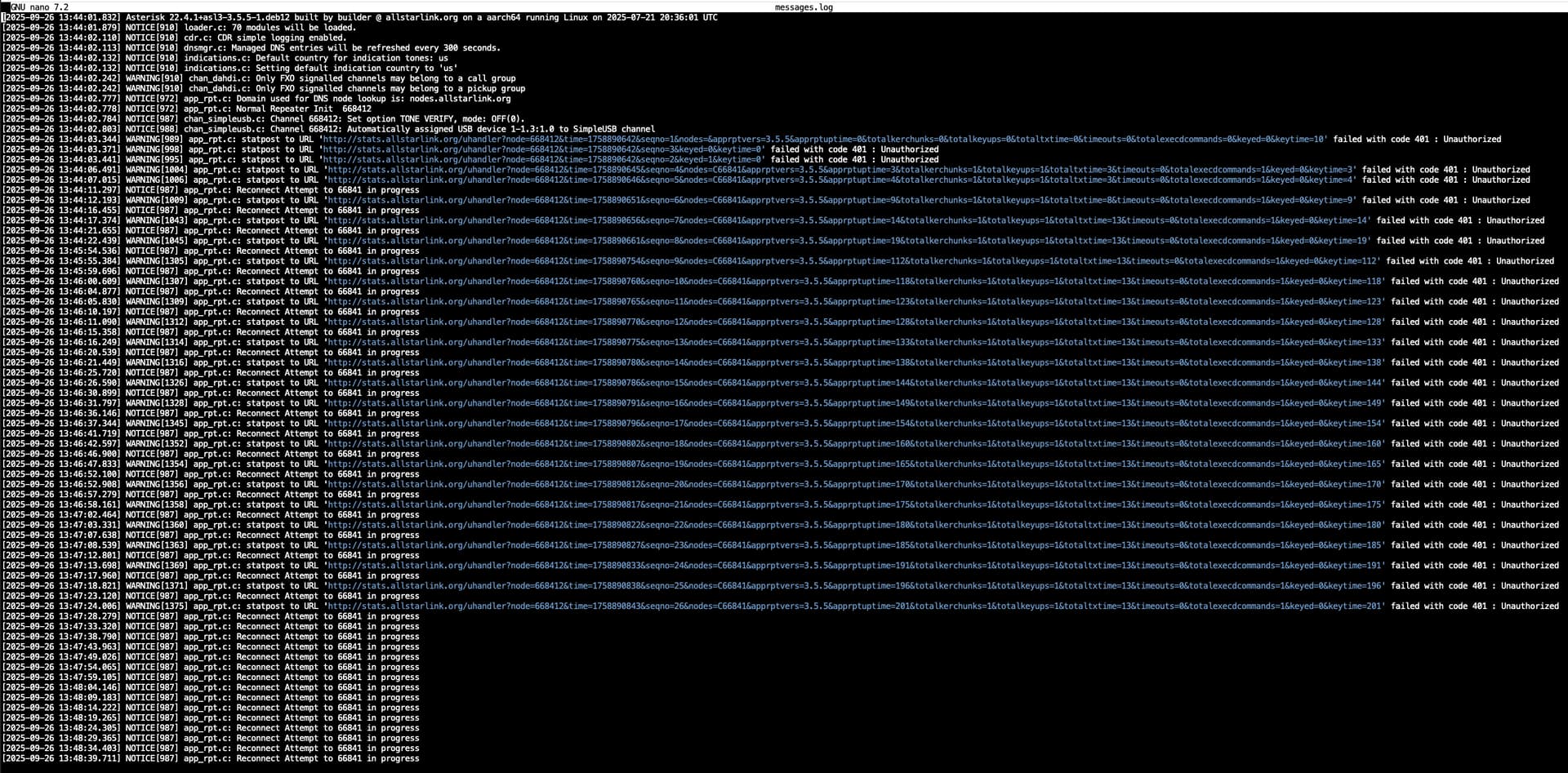

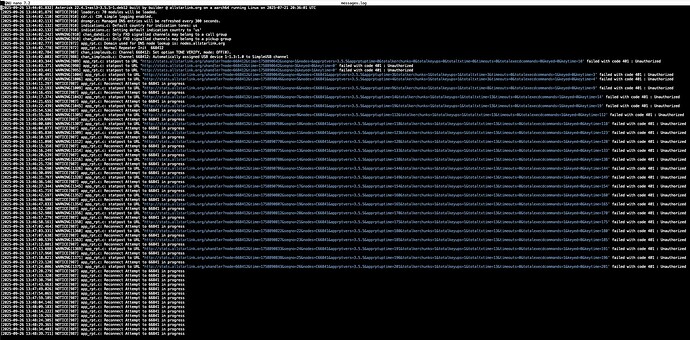

Hi, I appear to have a similar issue. I have waited the 24 hrs for the servers to update as per the instructions in the link WA3WCO posted above, but when trying to connect my 668412 to 688411 it appears to connect to 66841 (no extension) but of course this is not valid. Below is the output from /var/log/asterisk/messages.log - any suggestions on what I should try next? Thanks.
I have removed the leftover pre-NNX DNS records for node 66841.
... AND I think I know why the cleanup code didn't do what it was supposed to do. Getting the backend processing issue resolved **IS** on my list.
