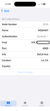

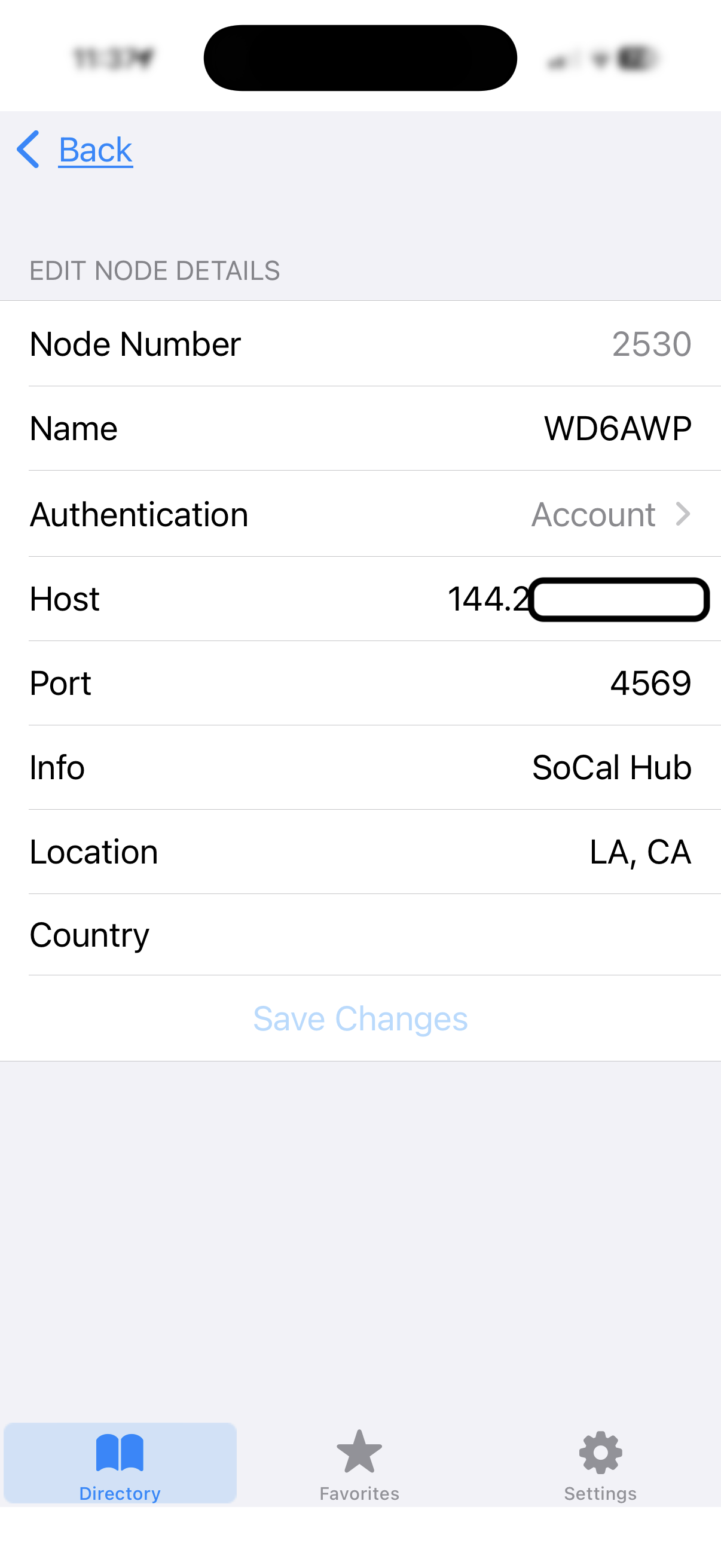

Both of mine fail 655100 and 655101
Both nodes fail to connect on AllStar. Fine on Echolink.
655100 and 655101

In case you didn't know, with RepeaterPhone you can select the "Directory" tab. Then, with the node list displayed, you can drag the list down from the top towards the bottom and when letting go it looks as if the app is refreshing its node list. That may (or may not) help.

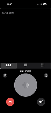

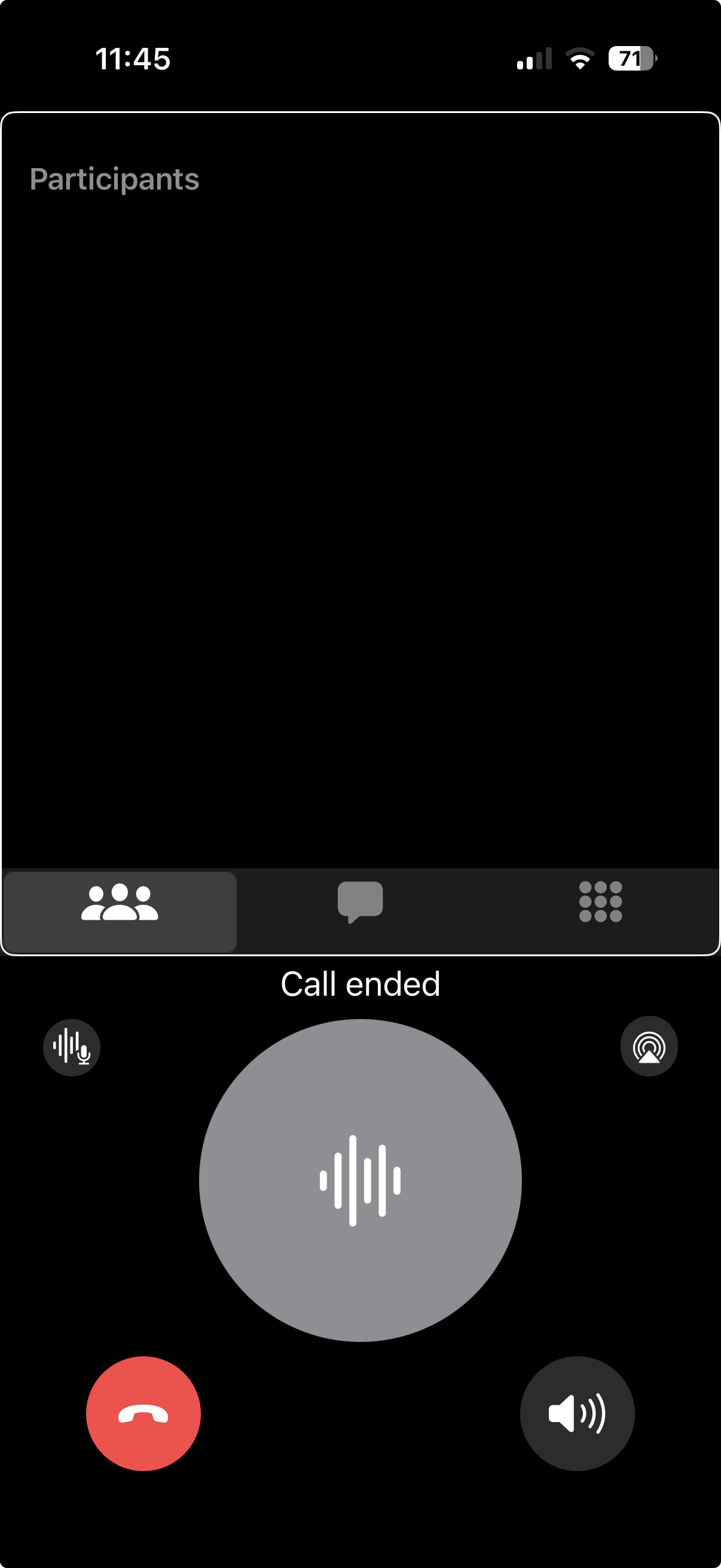

Still no connect from RepeaterPhone. Just rings.

... and, lastly, are you trying to use RepeaterPhone on the same local network as the nodes you are trying to connect with? If so, try using the cell network to connect from RepeaterPhone to the nodes (i.e. turn off WiFi on your phone).
I can connect successfully to 2503, 655100, and 655101. On 655100 and 655101 I made a transmission which appeared to work. On 2503 I'm listening to a QSO in process. The only thing I can offer is that I opened RepeaterPhone "cold" - i.e. wasn't already running in the background.
