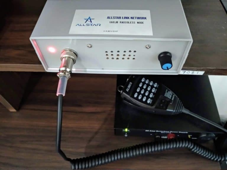

Sorry for the incomplete info. I’m running a C-media (CM119) usb adapter connected to an amp.
Basically this:
How did I Notice: sounds just like the video when time announcements and/or voice traffic is present on the attached speaker. I have also noticed similar distorted audio from my MIC on the repeater I’m connected to (via allstar).

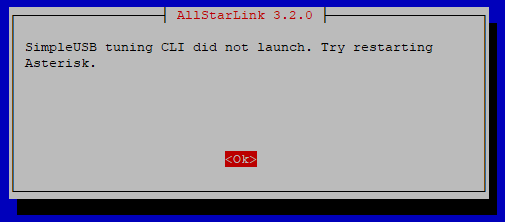

I tried the “wget -O- https://repo.allstarlink.org/hotfix/asl3-deb12-kernel28-fix.sh | sudo bash -x” and it appears it downgraded the node to -28 but I’m getting an error with the USB tuning when I rebooted (which I did three times):
I’ll leave it in this state in case you need me to check something. - Tom
After running the wget, I’m also getting an error with USB tune and the USB interface board has stopped working completely?
