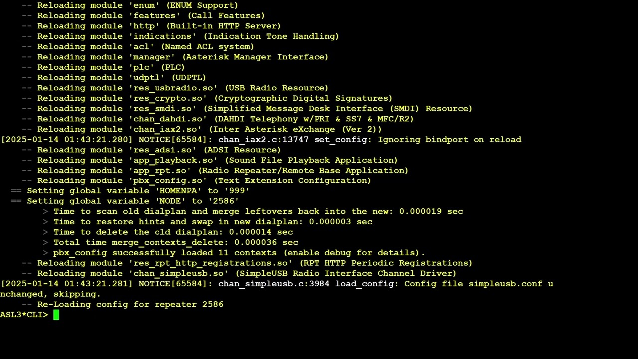

Here is a video showing it in action.
Telemetry audio has jitter and many very short duration holes in the transmit audio.
The benchmark is to issue a *904 test tone command which should generate a clean test tone.
Which it very much is not.
The there is also a huge variation in the frequency and pattern of the audio interruptions depending on what the software may be doing or where it is at.
I have hear it on rare occasion go “clean” for a number of seconds then come back to holepunched as it usually is.
Sometimes after an Asterisk “core reload” it would go clean for a bit, but usually not.
But in this video you can see me do this and the audio “holepunch” pattern changes significantly.
This test with the test tone being generated by asterisk/rpt will be my basis for further testing and investigation or a bug report to continue work on it.
—LINK—
