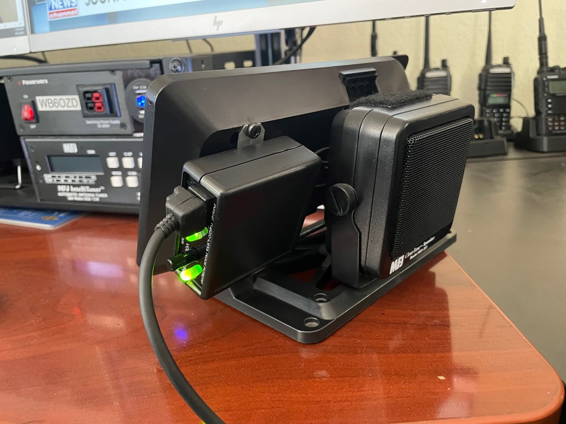

I’ve done it and have good results. I use a Pi3 with the 7" touchscreen (official Rpi version) with my own customized version of Allmon as the front end. Completely touchscreen driven with no keyboard required. I leave this unit on 24x7 as my radioless node to monitor our two repeaters.
As far as performance, it is usually crystal clear. I will say though that on restart, I usually wait a minute or two for everything to settle out as transmitting immediately after startup I have heard some garbled audio. It is rare, but it has happened. I haven’t had the time to redo this on a Pi4, but my guess is that it would completely disappear on that hardware due to the upgraded processing power and memory.

That’s a nice outfit. I have been working on one like it, if I ever finish.
Was writing my own display for stats and control.
Might I ask what the onscreen keypad was derived from ?
Guessing it was packaged with the touch software.
There isn’t any special touchscreen software. Touch registers just like a mouse click. The code is just html & javascript. When you click on the node # field on the main screen, it activates the modal form which sets the node number.
