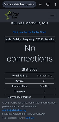

I recently brought back my node in the hopes of making it into a portable radioless node. While it works, it looks like the ASL website side of things is misreading my node status.
It is showing up correctly when i actiavte my node that it's active, however when i do boot it up, it is wrong by almost half a day or more for actual uptime. For example, in the photo below, i only had the node on for maybe less than 15 minutes and it shows up on the stats page that I've been active for almost 14 hours!!! While it's not really annoying, does anyone have any ideas on whats going on?
Thanks!
The connection time issue has been fixed in the package updates just released to the "beta" channel.
See 2025.06.05 - Package Updates - Beta Channel
Thanks, I'll have to check this out and update my node then. Much appreciated!
