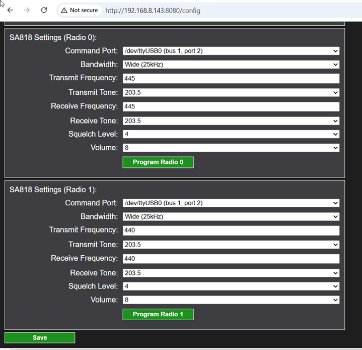

I did some work to allow the SA818 serial programming to happen directly from my node configuration screen. Actually, the HotSpot Radio duplex repeater has two SA818 modules so I created the ability to save/load two independent radio configurations (see below). Having a duplex hotspot is really nice.
