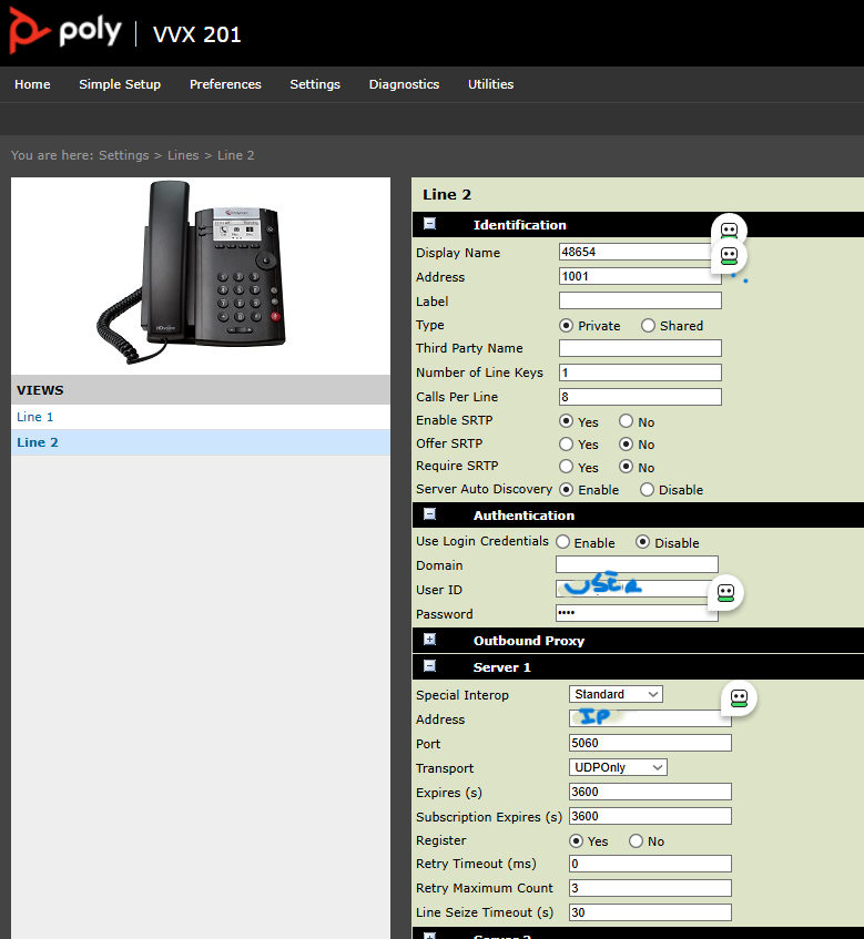

Following your progress (someone just gave me a VVX-450).
I got it working- updated the original post. I will add info on configuring the Polycom VVX 201 as well.
Polycom cfg- only using Line 2 cfg page- the simple setup/line 1 pages are used for line 1 phone number.
Line 2 for ASL3:
  • display name shows on the phone screen
  • address is the extension used in the cfg files
  • user/pass are from the pjsip.conf file
  • ip is local LAN ip of the ASL3 node
Hope this helps someone!
