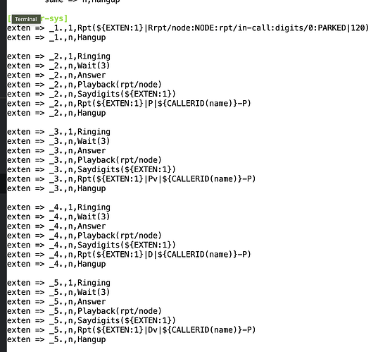

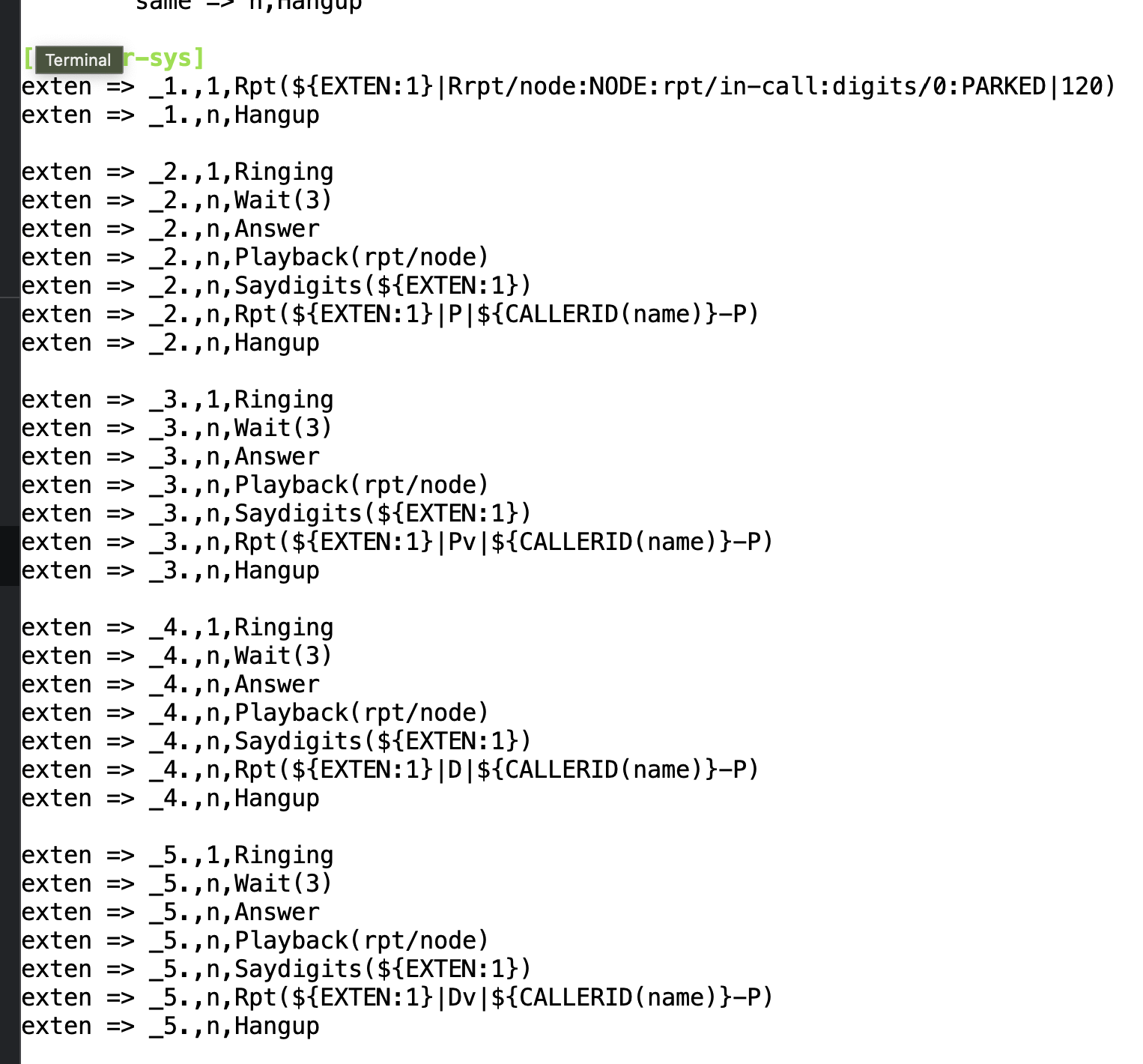

thsi is my extensions.conf:
That stanza is for registered nodes.[allstar-sys]
A private node is not a registered ASL Network connectable node.
See that which I posted above.

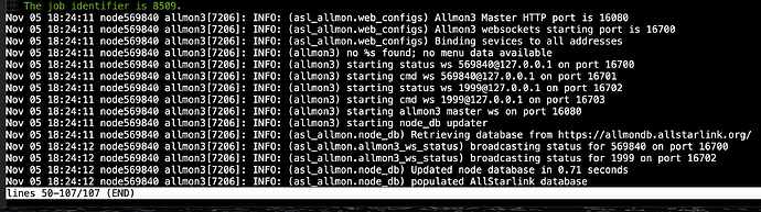

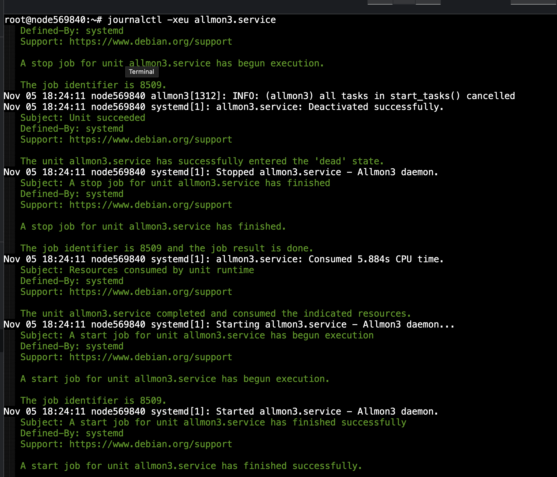

Same questions as before. Please restart allmon3 with systemctl restart allmon3 and then provide the output of journalctl -xeu allmon3.service.

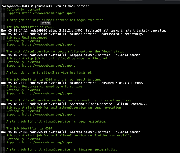

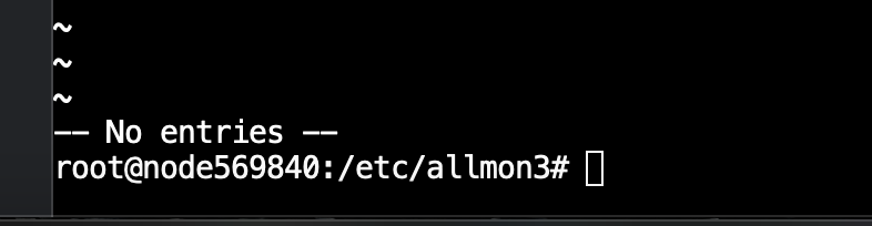

I did this again and now nothing in the journal.
systemctl restart allmon3, journalctl -xeu allmon3.service is Blank
This is not an Allmon3 problem at all then. You still have something misconfigured on your local system’s rpt.conf/iax.conf. Why do you need a private node at all?
