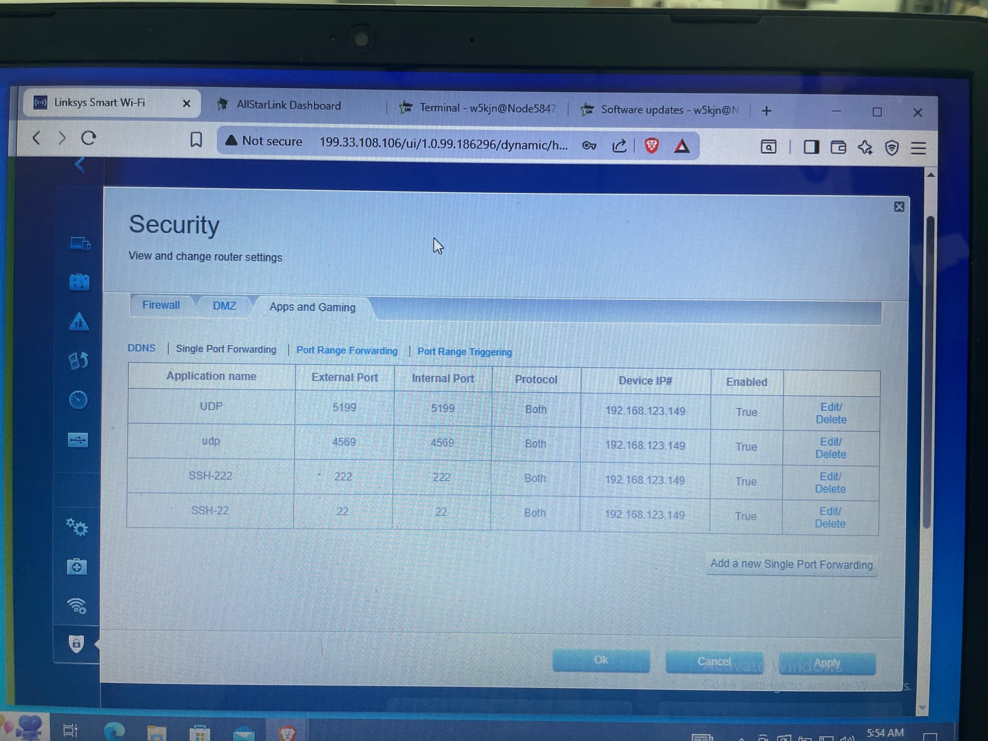

Can you describe the topology of your network(s )? Topology – The Site is the same place our ISP’s equipment. We have a 25 ft. piece of cat 5 coming from the ISP to our Linksys router. IP address is 199.33.108.106 (static) into the router from ISP. Local ip is 192.168.123.149 set (static) local gateway is 192.168.123.254. The connection from the router goes into a Raspberry pi4 with ASL3 loaded from there into a Masters Communcations RA-40. From there into a Motorola Mototrbo RPT – XPR8300. Inside the sotware using Duplex #2 in SimpleUSB.

is port 4569 what I would use for a Web Browser? Here is what I did
https://199.33.108.106:4569
Don't know if it's a dealbreaker but your IAX port forward should be set to UDP, not Both. I don't use Echolink so can't speak to that. Probably also a good idea to change the labeling to say what they're actually for, instead of two of them saying "UDP" (but maybe that's just me being pedantic...)

From a web browser, you would be accessing the system using TCP port 80 (HTTP), TCP port 443 (HTTPS), or TCP port 9090 (Cockpit).
SSH is SSH. The only thing that trips me up (on occasion) is when my desktop/laptop login differs from the remote host login. Just need to remember to specify the alternate login.
Port 4569 is the IAX2 port. For web browsing, you would be using ports 80, 443, 9090, ...
Sorry what I meant could SSH in using FileZilla. Could not get in using terminal. Does 4569 just need on UDP?
Got web browser working after a chap told me I needed 9090.didnt see that anywhere.
