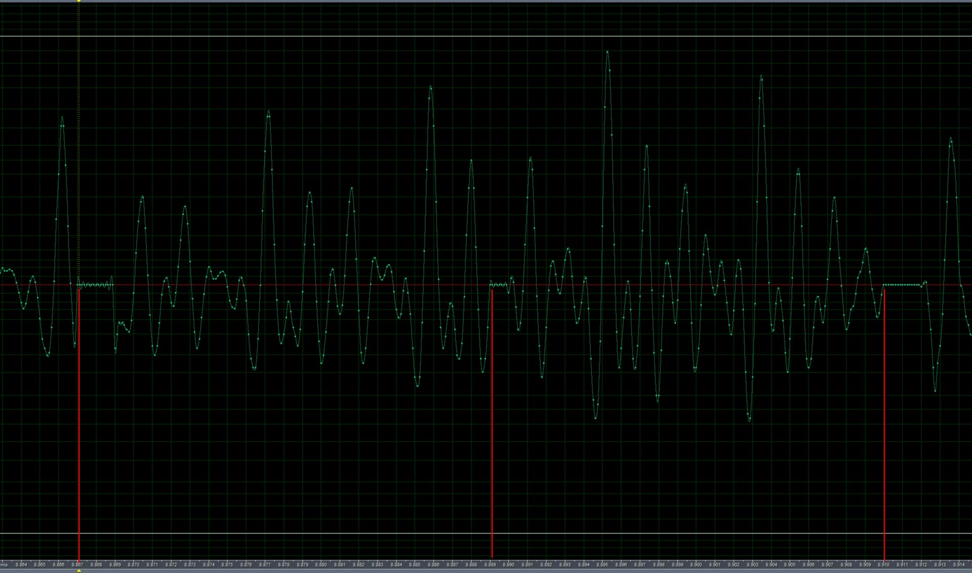

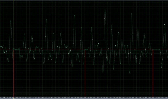

I have a node that had and still has some intermittent glitches in the USB rx audio (from URI ADC). This node had not been updated in a few months so I updated it to latest ASL3.3 and the issue was still there. I then tried updating to latest devel and that doesn't fix it either. sudo asterisk -V shows: Asterisk 22.2.0+asl3-3.4.2-1.deb12
I have another node with the same URI and everything is fine on that, it has Asterisk 20.11.0+asl3-3.2.0-2.deb12.
Here is what the glitches look like:
(from parrot wav file recorded by the node in /tmp/)
ie. there are anywhere from maybe 5 ~15 zero's in the PCM data, but only happens intermittently, maybe once every 10 to 20 seconds of audio, with maybe 8 or 9 out of 10 20mS USB frames then having a sequence of zero sample values (presumably at frame boundaries), resulting in some choppiness/distortion in the audio.
Please LMK of any suggestions on how to debug this issue on this node.
